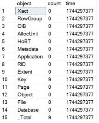

We can see this by restarting the server, and then creating a known number of deadlocks. For example, after restarting the SQL Server and intentionally creating 9 deadlocks in a row, and the output of the query looks like this:

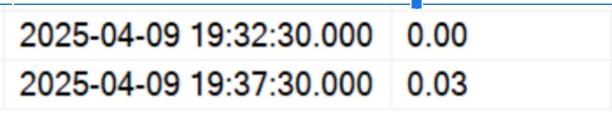

For example - in the above scenario, if all 9 deadlocks were created within a 5-minute polling interval, the probe would return the value "0.03" for deadlocks/sec during that interval:
The value for this metric is given as the number of deadlocks which occurred between polling intervals, divided by the polling interval in seconds, to generate the deadlocks per second.
