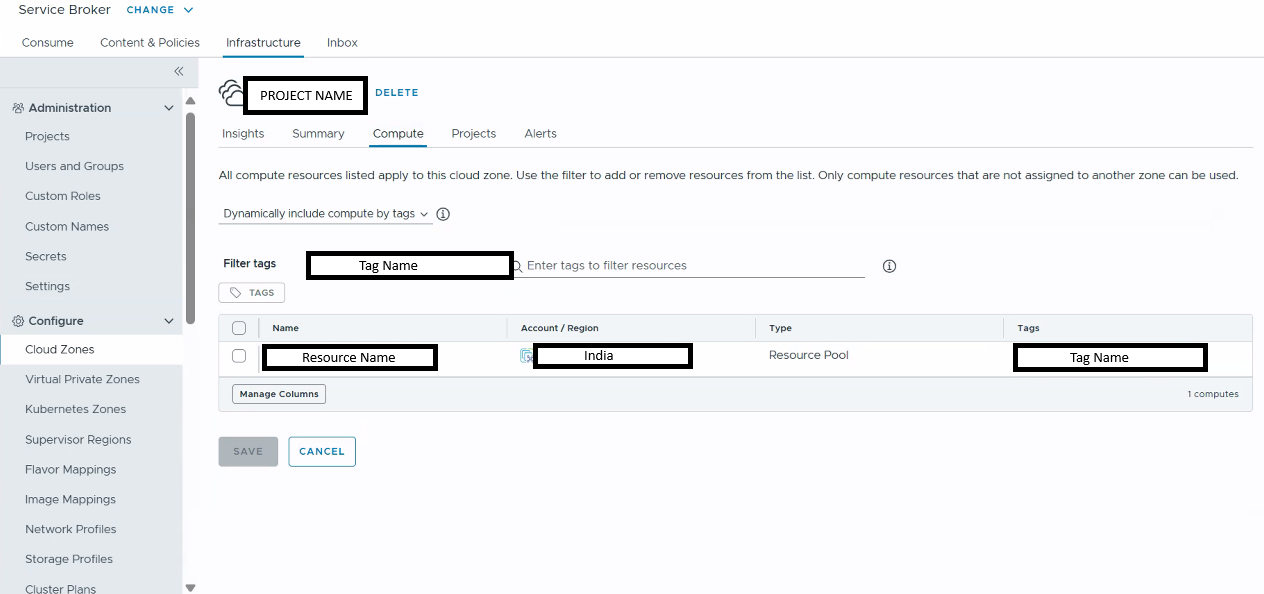

  • Verify the compute resources configured in the affected project.
    • Ensure that the project in Aria Automation has the appropriate cloud resources assigned.
  • If compute resources are missing, add the required cloud resources to the project to enable successful deployment.
