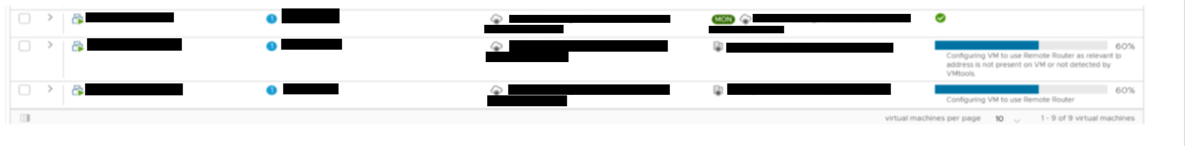

Configuring VM to use Remote Router as relevant IP address is not present on VM or not detected by VMtools.Configuring VM to use Remote Router.HCX Network Extension with MON feature enabled
