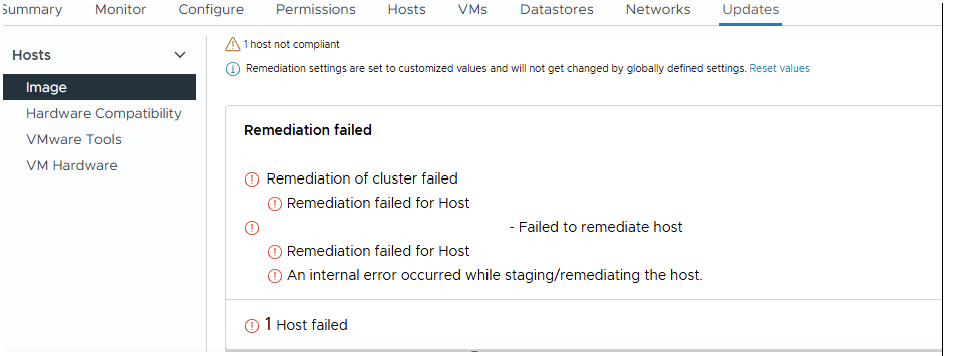

Remediation failed for Host. An internal error occurred while staging/remediating the host.

  • When attempting to remediate an ESXi 8.x host through the vCenter Server UI, the task fails during the staging process. Users observe an error in the vSphere Client stating: "Remediation failed for Host. An internal error occurred while staging/remediating the host."
