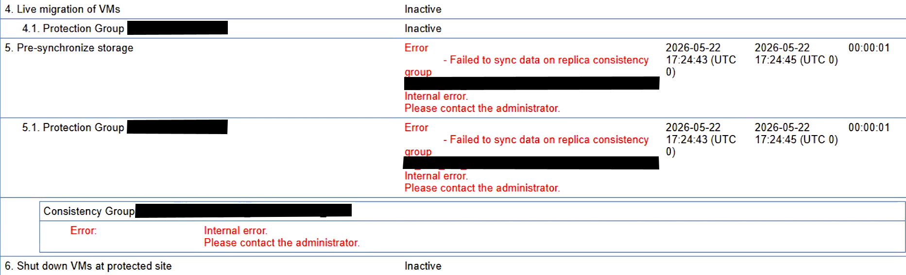

  • A VMware Site Recovery Manager (SRM) administrator initiates a "Planned Failover" or "Disaster Recovery" run.
  • The task fails during the "Synchronizing Storage" phase.
  • The following error is displayed in the SRM UI: Error - Failed to sync data on replica consistency group '[CG_NAME]'. Internal error. Please contact the administrator.
  • Note: A "Test Recovery" may complete successfully on the same Recovery Plan even while the actual DR run fails.
  • Re-trying the recovery plan fails with the same error.

The same can be verified by the vmware-dr.log which shows the below error messages for the recovery plan where SRM is receiving the LocalizableAdapterFault event from the SRA:
plan = 'dr.recovery.RecoveryPlan:#######-####-####-####-##########:########-####-####-####-############',
-->       planName = "Recovery_plan_name",
-->       planDescription = "",
-->       user = "######",
-->       startTime = "2026-05-22T16:06:00.342845Z",
-->       stopTime = "2026-05-22T16:06:02.09816Z",
-->       executionTimeInSeconds = 2,
-->       totalPausedTimeInSeconds = 0,
-->       resultState = "errors",
-->       warningCount = 0,
-->       errorCount = 2,
-->       poweredOnVms = 0,
-->       errorStateVms = 0,
-->       successfullyRecoveredVms = 0,
-->       ipCustomizedVms = 0,
-->       errorIpCustomizedVms = 1,
-->       poweredOffVms = 0,
-->       warnings = <unset>,
-->       errors = (vmodl.MethodFault) [
-->          (dr.storageProvider.fault.StorageDeviceGroupSyncFailed) {
-->             faultCause = (dr.storage.fault.LocalizableAdapterFault) {
-->                faultCause = (vmodl.MethodFault) null,
-->                faultMessage = <unset>,
-->                code = "123-456-789.-1",
-->                arg = <unset>
-->                msg = "Internal error.
--> Please contact the administrator."
-->             deviceGroup = "Consistency_group_name"
-->             msg = ""
-->                arg = <unset>
-->             msg = ""
