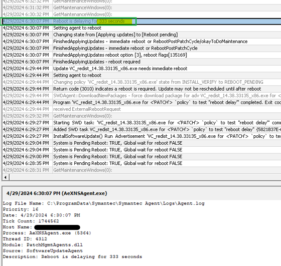

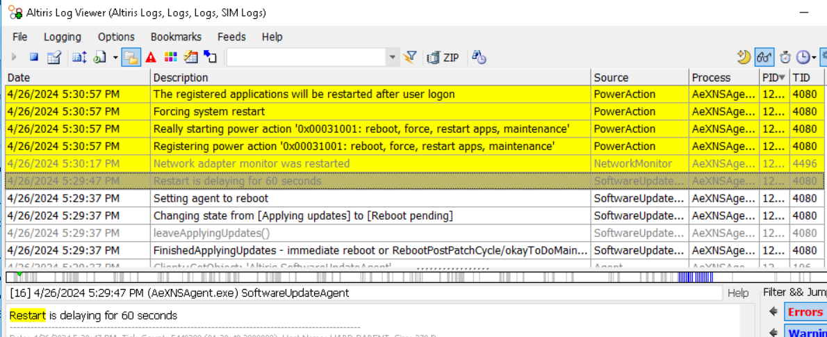

The agent logs should display this message referencing to the setting been active:
Restart is delaying for 60 seconds
as well any custom value been used:
