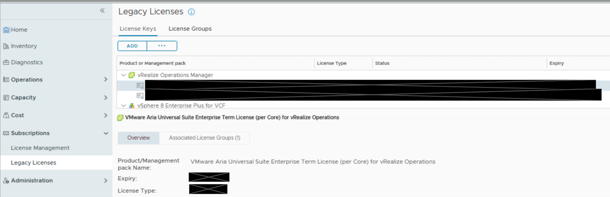

Control Panel - Access Control and Global Settings are missing from the Administration dropdown menu UI even with admin login.
VMware Aria Operations 8.18.x
The issue is due to missing legacy licensing.
Once applied the license under the Legacy Licenses, it reappeared after re-login.
Instructions on how to add to legacy licensing.
Subscription - Legacy Licenses - Add
