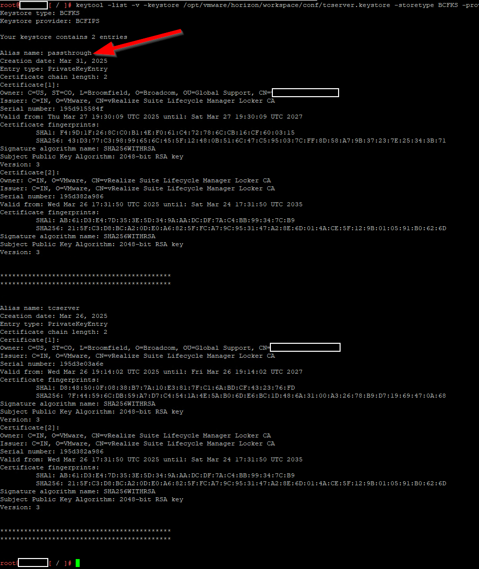

  1. Log into the vIDM server using SSH and get to a root level BASH prompt
  2. Use this command to confirm the certificate is in place
    keytool -list -v -keystore /opt/vmware/horizon/workspace/conf/tcserver.keystore -storetype BCFKS -providerclass org.bouncycastle.jcajce.provider.BouncyCastleFipsProvider -providerpath /opt/vmware/certproxy/lib/bc-fips-*.jar -storepass "$(grep keystore.password /opt/vmware/horizon/workspace/conf/catalina.properties | awk -F '=' '{print $2}')"
  3. Once it is confirmed that the certificate is present use this command to delete the passthrough certificate
    keytool -delete -keystore /opt/vmware/horizon/workspace/conf/tcserver.keystore -storetype BCFKS -providerclass org.bouncycastle.jcajce.provider.BouncyCastleFipsProvider -providerpath /opt/vmware/certproxy/lib/bc-fips-*.jar -storepass "$(grep keystore.password /opt/vmware/horizon/workspace/conf/catalina.properties | awk -F '=' '{print $2}')" -alias passthrough

  5. Confirm the certificate is gone by running the command from Step 2 again, then verify it shows as being cleared out on the System Dashboard and in the Passthrough Certificate tab for the appliance.
