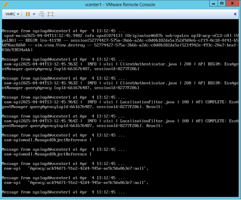

vCenter command line become overloaded of log messages after adjusting manually the log levels on syslog.conf.
On following the instructions of KB https://knowledge.broadcom.com/external/article/345261/ to edit the syslog.conf file, as sum as rsyslog service is restarted the SSH session or the vCenter CLI via console is flooded wiht log messages.
Sample from lab:
vCenter Server Appliance all versions.
Invalid entry on the syslog.conf file.
For instance, instead of using *.warn it is set as *warn*
Sample from lab:
rsyslog will output all the log entries to the command line session due to the wrong definition.
Adjust the syslog.config with the correct settings as the sample.
