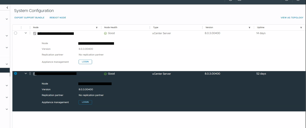

The administrator has freshly installed SRM on two different vCenters configured in Linked Mode. The SRM instances have registered correctly with their respective vCenters. However, in the vCenter interface, the vCenters in Enhanced Linked Mode (ELM) are not properly communicating the installation status
Live Site Recovery reconnect operation failed due to broken PSC replication.
