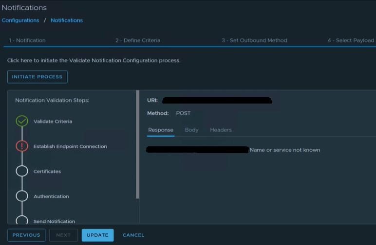

DNS resolution issue. Aria Operations is not able to resolve the endpoint Datadog URL.
In Operations > Configurations > Notifications, Test Notification process failed with "Name or service not known" error.

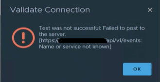

In Operations > Configurations > Outbound Settings, Test Validation on webhook also return "Name or service not known" error.
