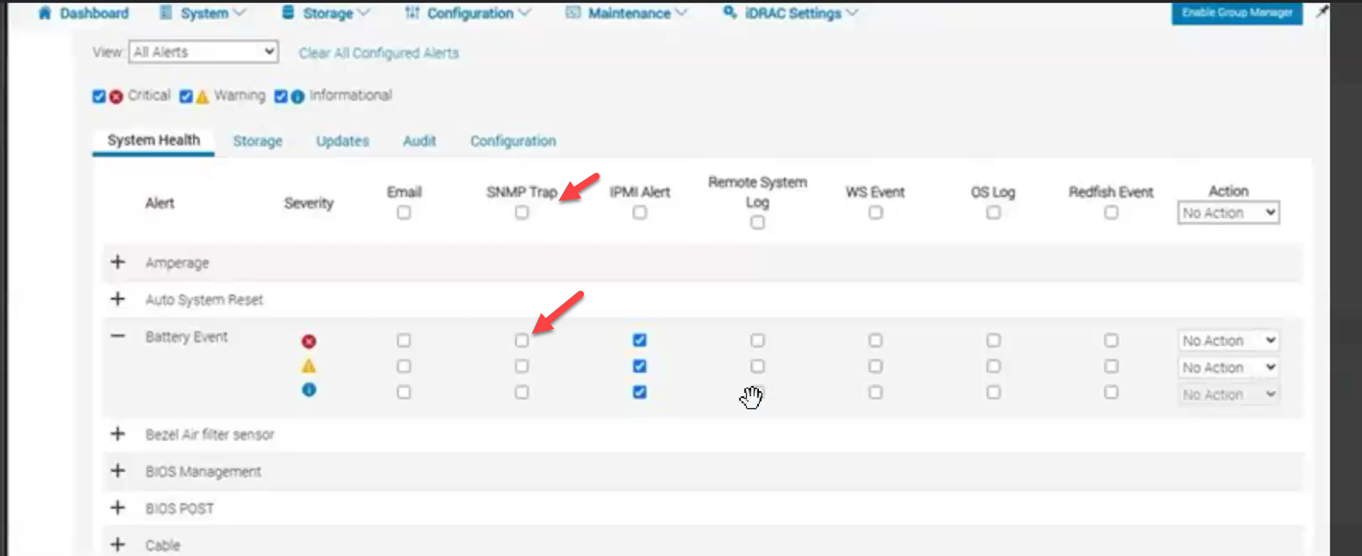

Monitoring using the snmptd probe and profiles created correctly but no traps received which did not trigger alert on CMOS battery failure on the target device
Any supported UIM environment
probe: snmptd
PowerEdge R440
The snmp trap configuration was missing on the device end which is required for the snmp traps to be send to the snmptd probe on battery failure events
