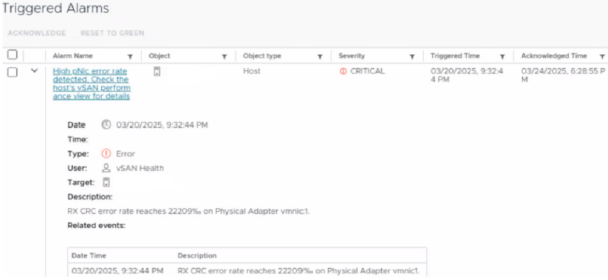

  • In vCenter UI, Cluster > Monitor > vSAN > Skyline Health might report the MTU Check errors for vSAN.
  • In vCenter UI, Host > Monitor > Triggered Alarms shows error as High pNic error rate detected.

  • High CRC errors are symptoms of the network issues. It could be a defective cable, SFP, or Network Interface Card (NIC) etc.
High PNIC errors can also be validated in /var/run/log/hostd.log
