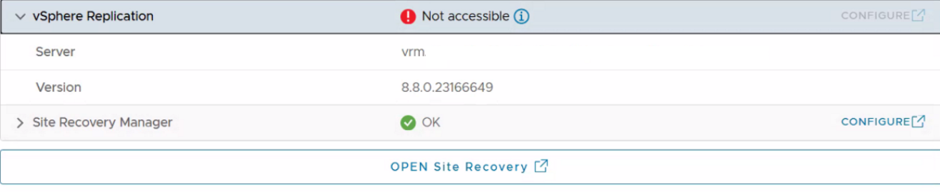

Symptoms:
  • vSphere replication server is "Not accessible " in vCenter UI.
  • The hostname of vSphere Replication appliance was changed from IP to FQDN.
  • Cannot open vSphere Replication VAMI on Summary page or reconfigure the appliance from the VAMI page.
