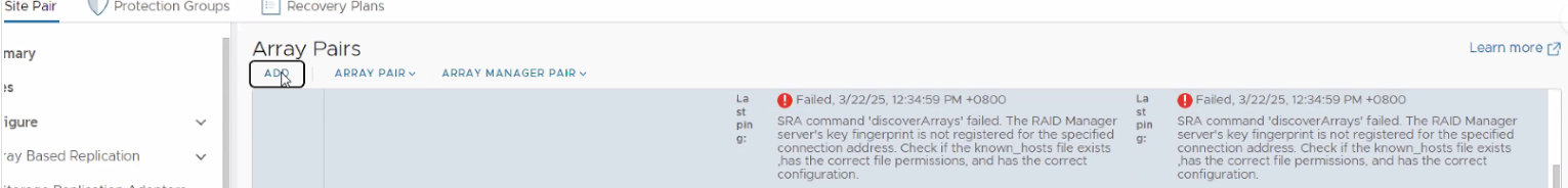

Symptoms :
  • When perform discover devices received below error message  from Site recovery UI
    Operation Failed
    SRA command 'discoverDevices' failed. The RAID Manager server's key fingerprint is not registered  for the specified connection address.
    Check if the known_hosts file exists ,has the correct file permissions, and has the correct configuration.
    Operation ID:######-8e04-####-##-#####74
