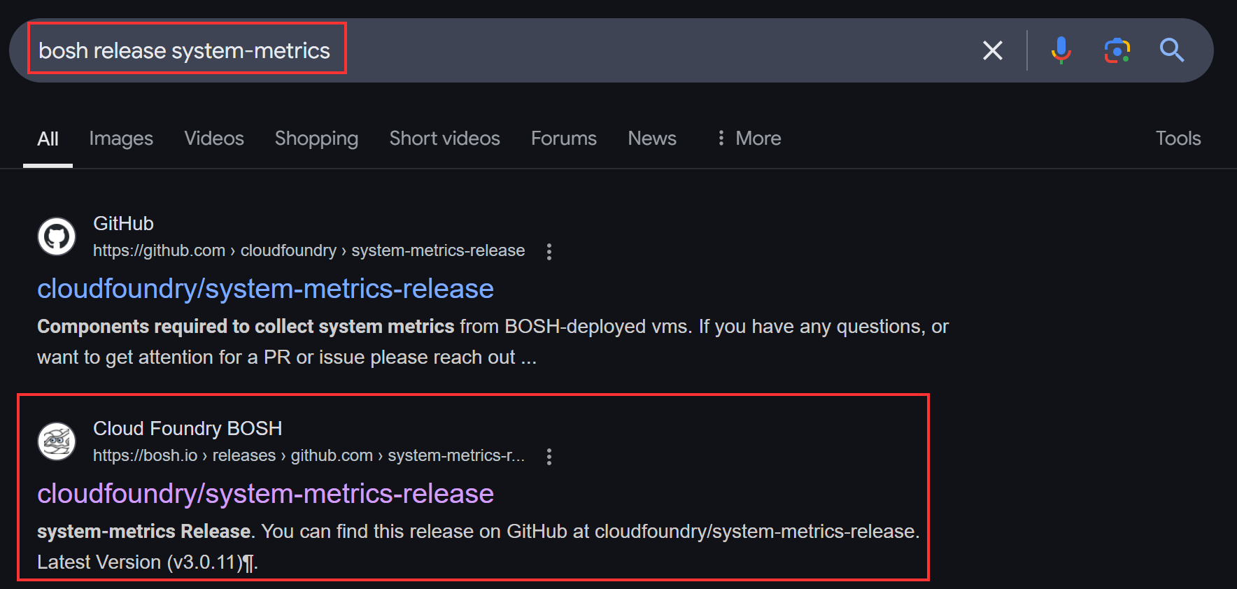

Releases coming from Bosh configs:
The job identified in the task.debug.log file may be coming from a Bosh config.
Bosh runtime configs are applied to all deployments. More information can be found in https://bosh.io/docs/runtime-config/

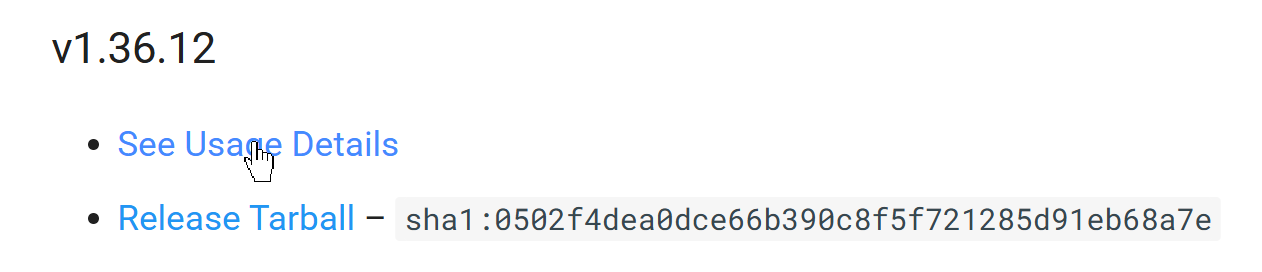

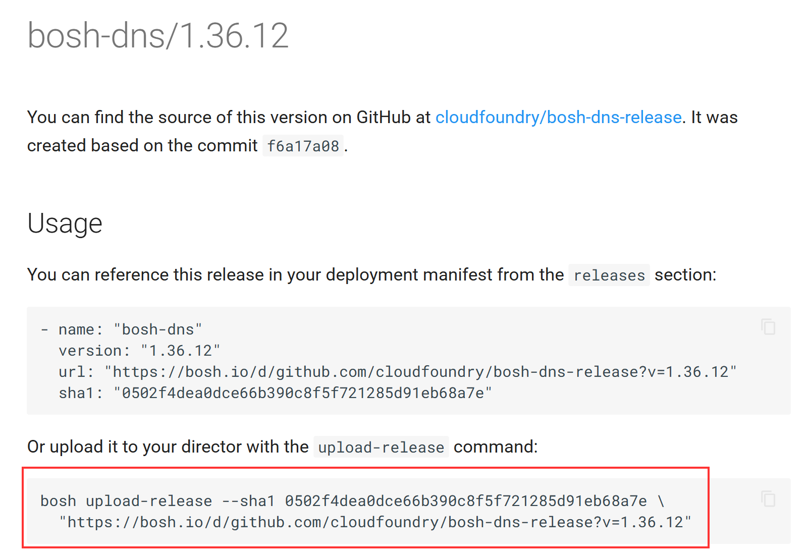

$ bosh config <bosh-config-id> jobs: - name: bosh-dns release: bosh-dns releases: - name: bosh-dns version: 1.36.12# bosh upload-release --sha1 0502f4dea0dce66b390c8f5f721285d91eb68a7e "https://bosh.io/d/github.com/cloudfoundry/bosh-dns-release?v=1.36.12" --fix

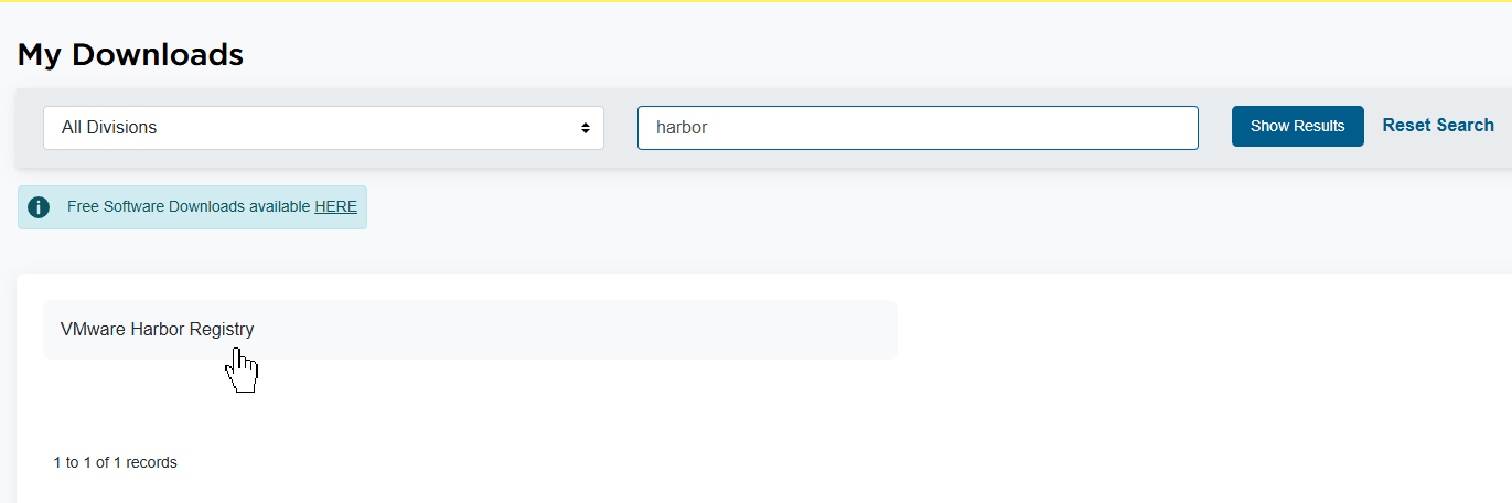

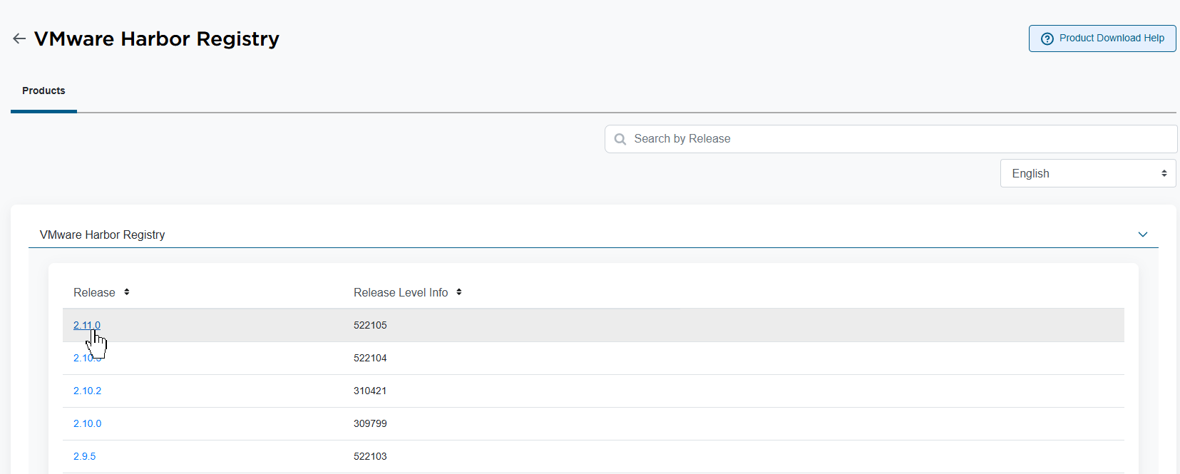

# unzip harbor-container-registry-2.11.0-build.2.pivotal# ls -lrt-rwx------+ 1 <user> UsersGrp 1140248413 Mar 22 14:08 harbor-container-registry-2.11.0-build.2.pivotaldrwxrwxrwx+ 1 <user> UsersGrp 0 Mar 24 13:02 metadatadrwxr-xr-x+ 1 <user> UsersGrp 0 Mar 24 13:02 migrationsdrwxrwxrwx+ 1 <user> UsersGrp 0 Mar 24 13:02 releases# ls -lrt releases/-rw-r--r--+ 1 <user> UsersGrp 1140190623 Mar 24 13:02 harbor-container-registry-2.11.0.tgz# bosh upload-release <release-name>.tgz --fix# bosh upload-release harbor-container-registry-2.11.0.tgz --fix
