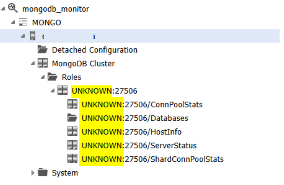

We have installed and configured the mongodb_monitor on multiple machines successfully.
We have 2 sets of clusters that will not return any information/data.
They do not use SSL and the permissions have been setup and the ID is able to reach them.
cluster nodes showing as UNKNOWN: <port>

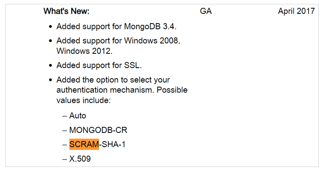

  • Unsupported mongodb database authentication mode
  • mongodb authentication mechanism SCRAM-SHA-256 is NOT currently supported. Currently as of the 3.01 GA release, only SCRAM-SHA-1 is supported as well as the other options displayed below which are mentioned in the mongodb release notes.
MongoDB Release Notes
Mar 17 09:29:20:104 [Data Collector - MONGO, mongodb_monitor] Running [serverStatus] command on [admin] database.
Mar 17 09:29:20:110 [Data Collector - MONGO, mongodb_monitor] serverStatus for server listening on port 27506 failed. Is it shutdown?

Mar 17 09:29:20:113 [Data Collector - MONGO, mongodb_monitor] Sending NimAlarm: {"severity":2,"subsystem":"mongodb_monitor","source":"<hostname.example>.com","message":"MongoDB instance [UNKNOWN:27506] is not running on this node."}
