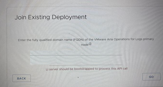

While joining a new worker node to an existing  Aria Operations for Logs deployment report error 'LI server should be bootstrapped to process this API call'
Connectivity issue with primary or master node
1) Validate the primary node IP address or FQDN entered is correct
2) Perform a nslookup and ping test from the joining node and validate the connectivity
3. Validate Ports required between cluster nodes by performing a curl test from worker node,  <https://ports.broadcom.com/home/VMware-Aria-Operations-for-Logs>
Add more worker nodes as needed. The cluster must have a minimum of three nodes.
