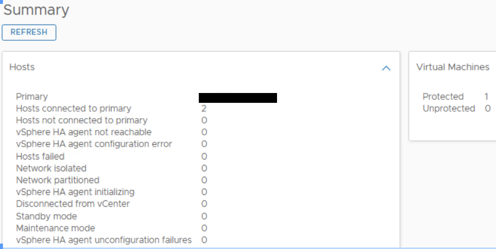

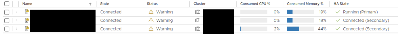

Lab Testing:
  • Test Setup: A three-host ESXi cluster with HA enabled:
  •  Primary host : esxi05

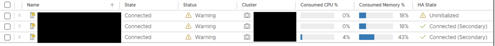

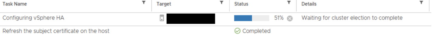

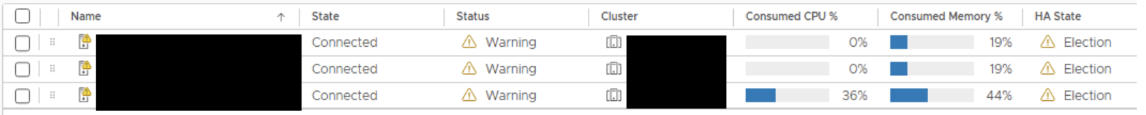

Lab Test 1: certificate renewed on the primary host in HA cluster
  • Certificate renewal initiated for ESXi, which triggered HA reconfiguration
  • HA agent became unreachable.
  • HA state changed to uninitialized.
  • HA state changed to Election for all hosts.

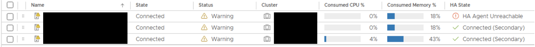

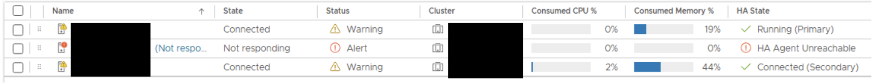

Lab Test 2: certificate renewed on the non-primary host in HA cluster
  • Certificate renewal was initiated for ESXi esxi06, which triggered HA reconfiguration.
  • Host state changed to not responding and HA state changed to Agent Unreachable
Observation:
  • In some instances, the disconnect is so brief that it goes unnoticed in the vCenter UI. For example, in Lab Test 1, the disconnect on esxi05 was minimal and did not impact HA behavior.
  • However, in Lab Test 2, esxi06 changed to a Not Responding state, indicating a complete disconnect from vCenter. In this situation, HA may initiate a VM failover.
Example : CPU reservations for the VMs impacted the failover process, preventing proper placement on other hosts.
