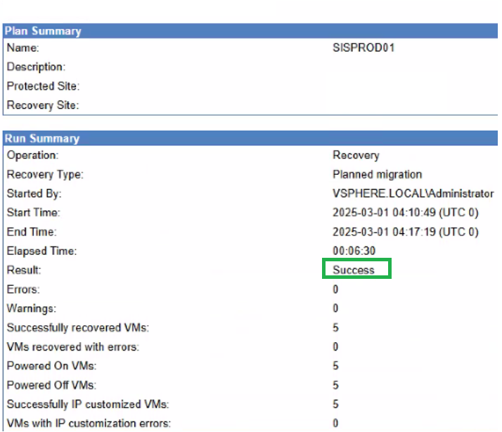

A planned migration was initiated, and all virtual machines in the recovery plan successfully failed over.

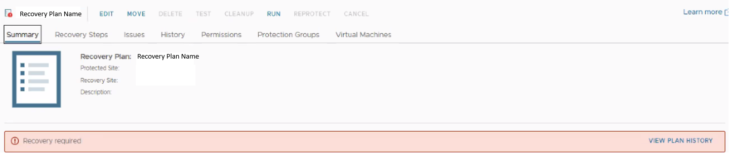

The Reprotect option is greyed out, preventing further actions.

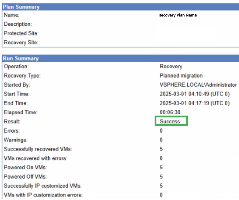

The history report indicates that the planned migration was completed successfully.
Virtual machines are successfully failed over and powered on at the DR site.

This issue occurs because the peer group monitor did not update the protection group state as expected. Ideally, the protection group state should transition to deactivated after the planned migration. However, since this state was not updated, the recovery plan entered a failedOverSplit state, causing it to display “Recovery Required.”
The exact reason for the delay in updating the group state is unknown. However, once the group state is eventually updated, the recovery plan status also updates accordingly.
From the /opt/vmware/support/logs/srm/vmware-dr.log file on the recovery site SRM appliance, we can see that the status of the recovery plan changed from failoverInProgress to failedOverSplit instead of failedOver
YYYY-MM-DDThh:mm:ss.msZ info vmware-dr[28586] [SRM@6876 sub=Recovery opID=d8a95864-74f9-4d6e-a14b-36bf93bacd18-failover:f1ba] [52f4b] Starting failover workflow for plan dr.recovery.RecoveryPlan:044cf05b-f434-40cc-9a10-2fe214ceef65:2fc4e937-5e15-40a9-946e-607bd87c4c96 'Recovery Plan Name' (planned)YYYY-MM-DDThh:mm:ss.msZ verbose vmware-dr[03280] [SRM@6876 sub=Recovery ctxID=9f8215c9 opID=d8a95864-74f9-4d6e-a14b-36bf93bacd18-failover:f1ba] [52f4b] Changing info.stateInfo.state : failoverInitiated -> failoverInProgressYYYY-MM-DDThh:mm:ss.msZ info vmware-dr[27213] [SRM@6876 sub=Recovery ctxID=9f8215c9 opID=d8a95864-74f9-4d6e-a14b-36bf93bacd18-failover:f1ba] CalculatePlanState: [2fc4e937-5e15-40a9-946e-607bd87c4c96] Plan has an override state: failoverInProgressYYYY-MM-DDThh:mm:ss.msZ verbose vmware-dr[27213] [SRM@6876 sub=Recovery ctxID=9f8215c9 opID=d8a95864-74f9-4d6e-a14b-36bf93bacd18-failover:f1ba] CalculatePlanState: split detail: startedProtectionVmsPowerOff=1, allProtectionVmsPoweredOff=1, activeYYYY-MM-DDThh:mm:ss.msZ verbose vmware-dr[27213] [SRM@6876 sub=Recovery ctxID=9f8215c9 opID=d8a95864-74f9-4d6e-a14b-36bf93bacd18-failover:f1ba] CalculatePlanState: [2fc4e937-5e15-40a9-946e-607bd87c4c96] Local state is failedOverSplit (peer state not accounted for)YYYY-MM-DDThh:mm:ss.msZ verbose vmware-dr[27213] [SRM@6876 sub=Recovery ctxID=9f8215c9 opID=d8a95864-74f9-4d6e-a14b-36bf93bacd18-failover:f1ba] CalculatePlanState: [2fc4e937-5e15-40a9-946e-607bd87c4c96]: Remote peer state is peerFailedOverYYYY-MM-DDThh:mm:ss.msZ info vmware-dr[27213] [SRM@6876 sub=Recovery ctxID=9f8215c9 opID=d8a95864-74f9-4d6e-a14b-36bf93bacd18-failover:f1ba] CalculatePlanState: [2fc4e937-5e15-40a9-946e-607bd87c4c96] Plan state is failedOverSplitYYYY-MM-DDThh:mm:ss.msZ verbose vmware-dr[27213] [SRM@6876 sub=Recovery ctxID=9f8215c9 opID=d8a95864-74f9-4d6e-a14b-36bf93bacd18-failover:f1ba] Changing info.stateInfo.state : failoverInProgress -> failedOverSplitAfter sometime, we can see that the peer state changed from active to deactivated after which the plan status changed from failedOverSplit to failedOver
YYYY-MM-DDThh:mm:ss.msZ info vmware-dr[03280] [SRM@6876 sub=Replication opID=2f48728a] Transitioning peer state of group 'vm-protection-group-1830:dr.replication.VmProtectionGroup:044cf05b-f434-40cc-9a10-2fe214ceef65' from 'active' to 'deactivated'YYYY-MM-DDThh:mm:ss.msZ verbose vmware-dr[28422] [SRM@6876 sub=Recovery ctxID=9f8215c9 opID=b3e7a8f5] Recalculating state for plan: [dr.recovery.RecoveryPlan:044cf05b-f434-40cc-9a10-2fe214ceef65:2fc4e937-5e15-40a9-946e-607bd87c4c96]YYYY-MM-DDThh:mm:ss.msZ verbose vmware-dr[28422] [SRM@6876 sub=Recovery ctxID=9f8215c9 opID=b3e7a8f5] CalculatePlanState: [2fc4e937-5e15-40a9-946e-607bd87c4c96] Local state is failedOver (peer state not accounted for)YYYY-MM-DDThh:mm:ss.msZ verbose vmware-dr[28422] [SRM@6876 sub=Recovery ctxID=9f8215c9 opID=b3e7a8f5] CalculatePlanState: [2fc4e937-5e15-40a9-946e-607bd87c4c96]: Remote peer state is peerFailedOverYYYY-MM-DDThh:mm:ss.msZ info vmware-dr[28422] [SRM@6876 sub=Recovery ctxID=9f8215c9 opID=b3e7a8f5] CalculatePlanState: [2fc4e937-5e15-40a9-946e-607bd87c4c96] Plan state is failedOverYYYY-MM-DDThh:mm:ss.msZ verbose vmware-dr[28422] [SRM@6876 sub=Recovery ctxID=9f8215c9 opID=b3e7a8f5] Changing info.stateInfo.state : failedOverSplit -> failedOverAs mentioned in the Cause section, the reason for this behavior is unknown, but the group state will update automatically after some time, resolving the issue.
If immediate resolution is needed, restart the SRM services to force an update of the group state. This will correct the recovery plan status and restore normal functionality.
