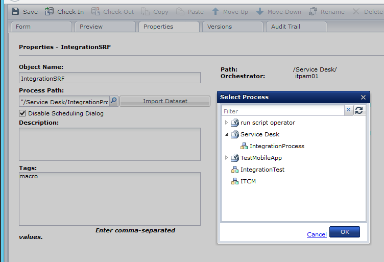

2. Right click the SRF, and select properties. To make the SRF available in Service Desk macros, we need to add the tag macro in it.
    Under properties, select tags tab, Edit, and add the word: macro. Then save
3. Associate the process (IntegrationProcess) to the SRF. For this, In the Library, right click the SRF, select Edit. In the new window, select Properties tab, and select the path to the process in "Process Path". Then save, and make sure the SRF is checked out (Check Out button in the menu).

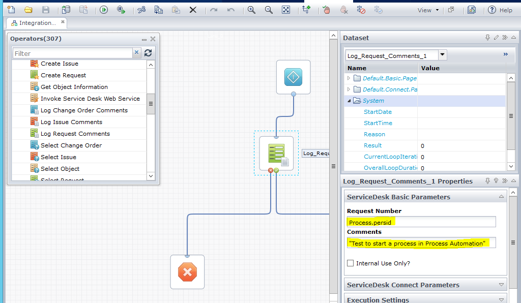

    From Service Desk folder in Operators windows, drag and drop to the process the Log Request Comment operator, and link it to start operator, abnormal stop operator and stop operator.
5. Select the Log_Request_Comments operator in the process, and in Properties window, expand Service Desk Basic Parameters, and make sure to fill
Request Number with Process.persid,  and Comments with "Test to start a process in Process Automation".
The effect of this is that when the process is started, it will make a log comment "Test to start a process in Process Automation" to the Request that initiated the process from Service Desk.

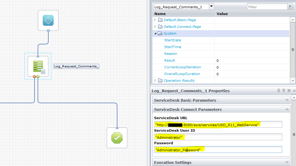

6. Now in Properties window, expand Service Desk Connect Parameters, and set the parameters to connect to Service Desk from PAM.
    In ServiceDesk URL, you need to fill http://<servicedesk_server_running_web_services>:<web_service_port>/axis/services/USD_R11_WebService
    In ServiceDesk user ID, you need to fill the user used to connect to Service Desk. This user needs to have the proper authorization, in this case to add a log comment to a ticket.
    In Password, you need to fill the password for the ServiceDesk user ID.
NOTE: Alternatively this settings can be set at Domain Level, in which case it is not necessary to put it at process level. Using Domain Level settings for the Service Desk module is recommended for administration purposes. It is easier to change settings at one place in domain level, than changing each process settings.

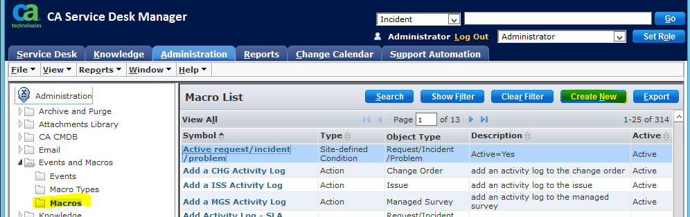

7. First step is to create a macro to start a Process Automation process. Under Administration tab, select Events and Macros->Macros, and then Create New
    Make sure to select as Macro Type: Execute CA IT PAM Action, and Object Type: Request/Incident/Problem

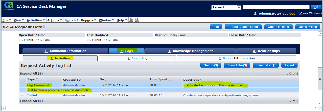

15. Once created, you will need to refresh the ticket. Under Logs->Activities, it will appear the log comment we set in the process.

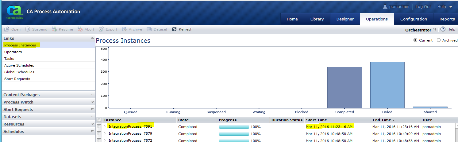

16. You may check the process in Process Automation, under Operations tab->Process Intances. Double clicking the instance will open it and you may see the results.
