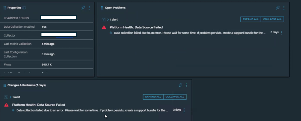

  • The status for the NSX-T data source is in failed stated (like below snippet).
  • From the latest.log in the collector bundle, below error log can be seen.
ERROR dataprovider.utils.HttpUtils NSXT-XXXX.com_Config_OpMgr-0 checkCodeAndThrow:53 Could not get response for /policy/api/v1/infra/domains/default/groups/vRNI-Node_Group_Profile_TN_XXXXXXXX-8576-40e9-8007-XXXXXXXX, status 400

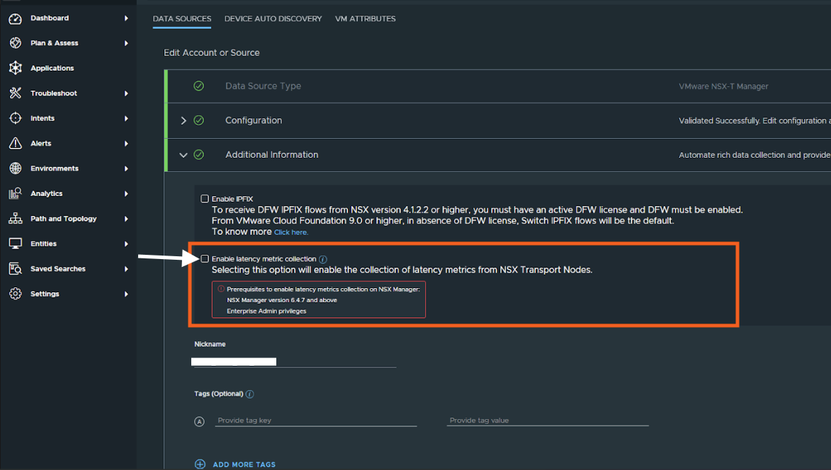

Workaround:
To resolve the data collector issue, please navigate to Settings > Data Source > Click on Edit for NSX-T Data source > Uncheck this "Enable Latency metric collection" > Click Save/OK.
Now wait for 30 minutes and Check this again ("Enable Latency metric collection" ) by editing the NSX-T datasource.
