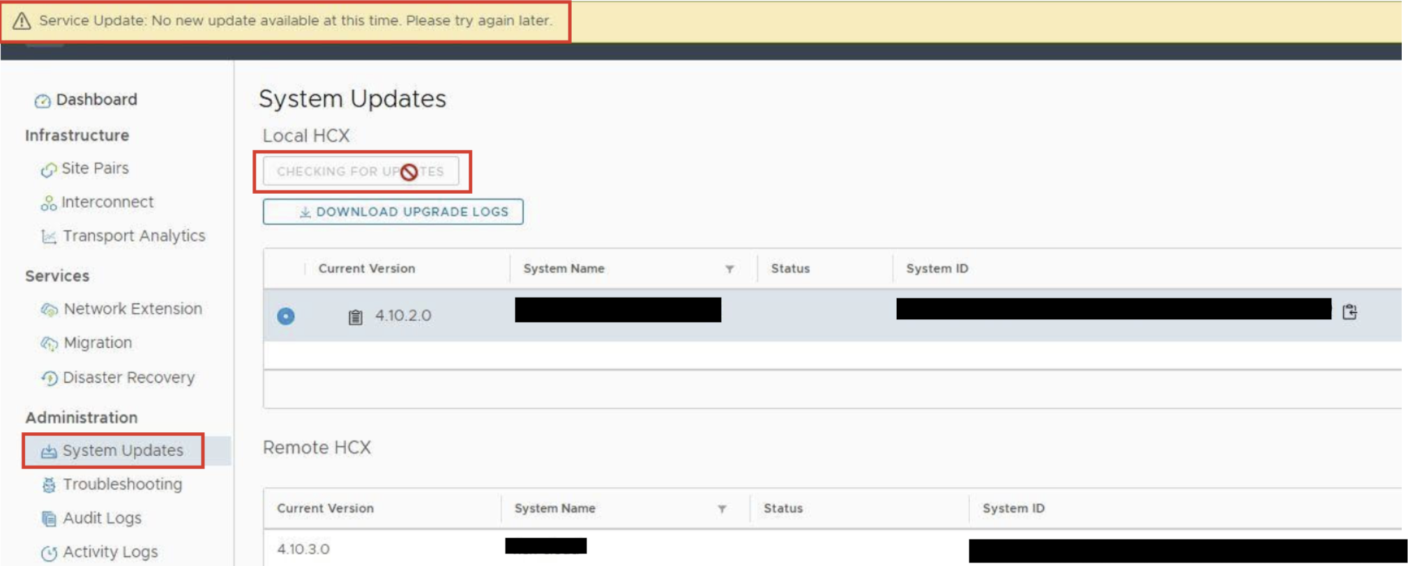

Check for Update fails "Service Update: No new update available at this time. Please try again later."

  • HCX Hybridity UI (port 443) encountered an issue where the "CHECK FOR UPDATES" process fails, displaying the message: "Service Update: No new update available at this time. Please try again later."

  • The following error is logged in the HCX Manager :
    /common/logs/admin/web.log
    2025-03-04 07:42:26.603 UTC [https-jsse-nio-127.0.0.1-8443-exec-10, Ent: HybridityAdmin, , TxId: TxId: ####-###-###-#####] INFO  c.v.v.h.m.VrealmApplianceMgmtRestController- Queued Check for upgrade job with ####-###-###-#####
    /common/logs/admin/app.log
    2025-03-04 07:42:26.638 UTC [VrealmUpgradeService_SvcThread-4, Ent: HybridityAdmin, , TxId: TxId: ####-###-###-#####] INFO  c.v.v.h.s.u.PullUpgradeNotificationJob- Starting to run PullUpgradeNotification Job(####-###-###-#####):BEGIN
    2025-03-04 07:42:29.076 UTC [VrealmUpgradeService_SvcThread-4, Ent: HybridityAdmin, , TxId: TxId: ####-###-###-#####] INFO  c.v.v.h.s.u.PullUpgradeNotificationJob- Starting to run PullUpgradeNotification Job(####-###-###-#####):FETCH_NOTIFICATION
    2025-03-04 07:42:29.080 UTC [VrealmUpgradeService_SvcThread-4, Ent: HybridityAdmin, , TxId: TxId: ####-###-###-#####] INFO  c.v.v.h.s.u.PullUpgradeNotificationJob- Check For Upgrade: No Upgrade Available at this time
