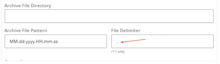

We found the File Delimiter in the Scheduler Definition->Advanced->Archived File configuration was set to a period instead of a comma.
1. Deleted the scheduler
2. Added the scheduler back and used a comma for the "File Delimiter" section of the Archive File configuration in the Scheduler Definition's Advanced tab
3. Verified in the logs that the archived_event files were processed and no longer displayed the warning
