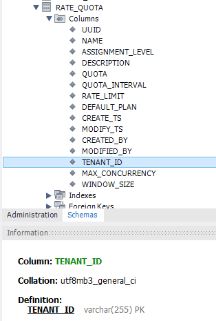

When checked the table RATE_QUOTA, found that it's using utf8mb3 collatioin,
And the table API_ORG_RATE_QUOTA_XREF is using utf8mb4,
utf8mb3 should be from mysql 5.7, if follow the document below to upgrade to mysql 8, it should be utf8mb4,
https://techdocs.broadcom.com/us/en/ca-enterprise-software/layer7-api-management/api-developer-portal/5-2/install-configure-and-upgrade/install-portal-on-docker-swarm/upgrade-portal-database-to-mysql-8.html
May need to alter the collation to utf8mb4 before upgrade.
