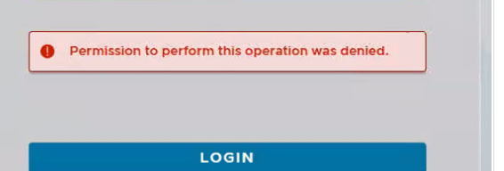

  • After adding an ESXi host to Active Directory and configuring the "ESX Admins" group in AD, any user that is part of the "ESX Admins" group should automatically be given VIM Admin role on the ESXi, however attempted AD user logins fail to the Host UI or with SSH.

  • When ESXI host was already configured with AD but the ESXi UI login for AD user failing with error
  • System permissions on the affected ESXi host will not list the AD domain or the "ESX Admins" group
