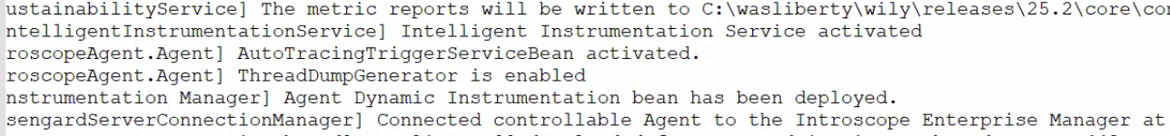

4.Verify from the Agent log that appsever starts without any issue and is able to connect to the APM server side, below an example:

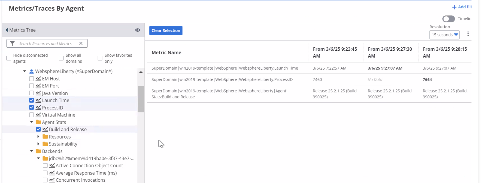

5. Finally confirm that metrics are correctly reported in Metric view
