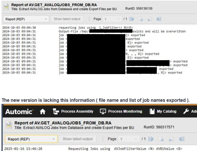

Additionally, some information about the jobs that had been exported from Avaloq to AE that had previously been written to the Report are now written to the Agent Log instead.
Below, Report from the old RA Avaloq Agent and the new Integration Avaloq Agent where the difference in the Report can be seen (in Integration Avaloq Agent the missing messages were displayed in the Agent log instead).
