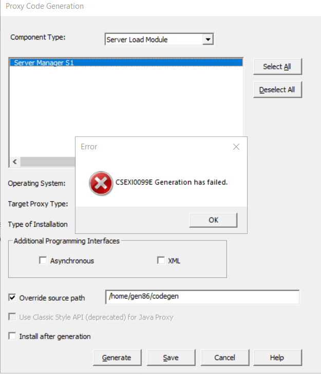

Gen 8.6 Linux/Oracle CSE Java Proxy generation fails with:CSEXI0099E Generation has failed
CSE Error Messages > CSEXI0099
Checking iefmd.log file shows the proxy generator encypyg is not getting invoked with its full PATH:ERROR: Problem invoking 'encypyg "A6138323 CSE" ENCYADMN "DBNAME=DBCSE DBUSER=#####@###### DBPSWD=##### " server_name/2500 CSE_ENV ENCY "/home/gen86/codegen/proxy/java" JVM JAVAPROXY2 IIS * "/opt/Gen/CSE/cse/logs/ENCYADMN/genstat.ctl" N N 57031' executable.Path or portion of path doesn't exist.
