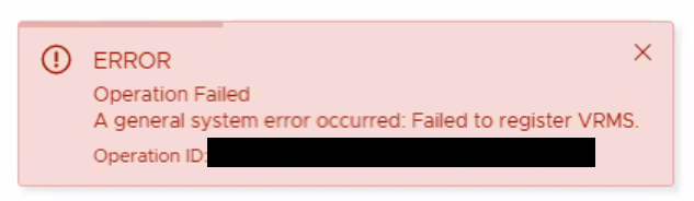

  • LDAP user accounts with administrator privileges fail to register the appliance to vCenter.
  • Single Sign-On (SSO) user accounts with global administrator privileges also fail to register the appliance to vCenter.
  • Registering the appliance using administrator@mydomain/administrator@vsphere.local works as expected.
ERROR
Operation Failed
Insufficient permissions to perform this operation.
Operation ID: ########-####-####-####-############
