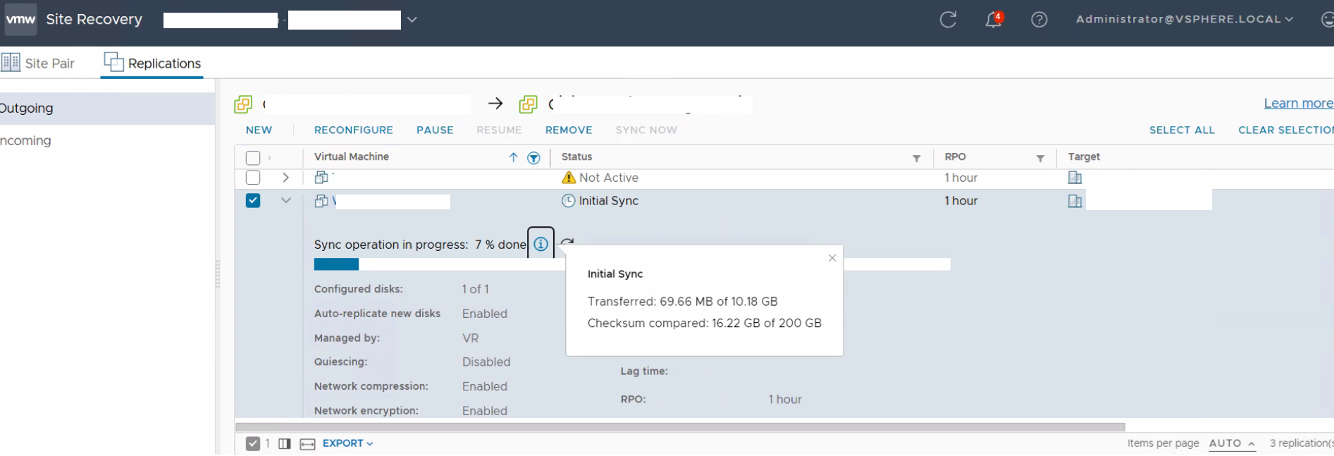

Symptoms:
  • Virtual machine replication is taking a long time to finish with no error displayed.
  • Regardless of whether legacy replication or enhanced replication is used, any VMs configured for replication experience slowness.
  • From the /var/run/log/hostd.log, the replication bandwidth will report low, which confirms slow data transfer.
2026-04-01T11:10:23.131Z In(166) Hostd[2100761]: [Originator@6876 sub=Hbrsvc] ReplicationScheduler: starting replica for group GID-4388655c-a5fb-47a7-af2a-########. Estimated maximum duration: 18907 seconds. Estimated average bandwidth: 0.28 MB/s.
  • If a recovery plan is executed while a virtual machine is in an active synchronization state, the recovery plan may fail due to the replication status being incomplete.
  • Transferred data increases very slowly:
    • 11.6 MB --> 12.4 MB --> 13.6 MB --> 14.9 MB
This confirms:
  • Replication is working but speed is low due to network issues
