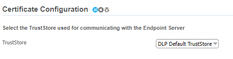

  1. Confirm if the default certificates are set for both the Endpoint Detection Server and when the Agent was built.
    1. For the Endpoint Detection server:
      In the Enforce Console, navigate to System > Servers and Detectors > Overview > Select the Endpoint Detection Server > Configure > Certificate Configuration
    2. For the Endpoint Agent, what certificate was selected when building the Agent in the Enforce Console > System > Agents > Agent Packaging?
