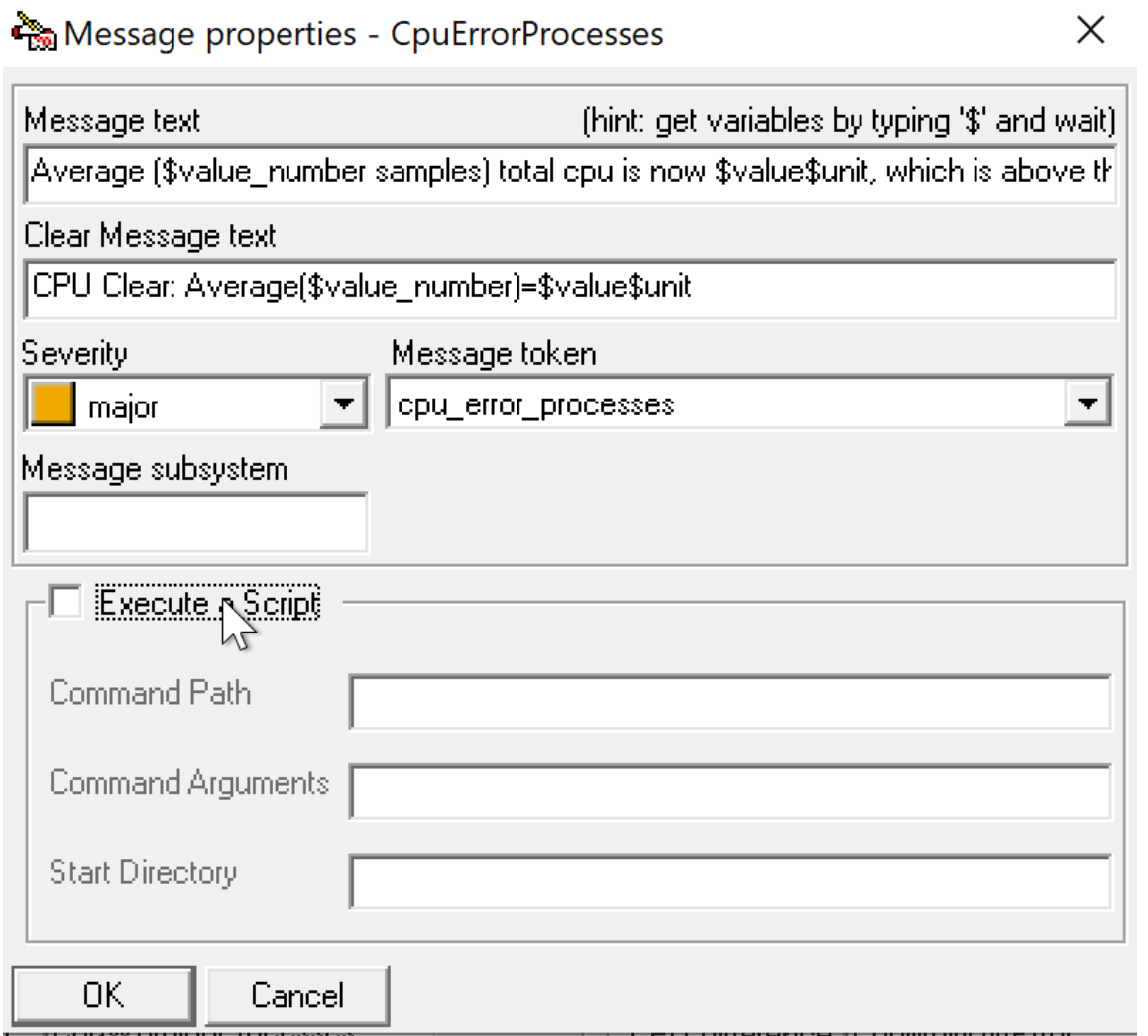

Method 2 - execute a script when a specific threshold is breached
Starting in CDM 7.22 the option exists to run a specific script when a specific threshold is breached.
This is only accessible in the Infrastructure Manager GUI for CDM and is located under the 'Setup' tab, "Message definitions" sub-tab.
In this tab, locate the message that corresponds with the threshold you are interested in - for example, the "Major" threshold for CPU Usage as seen here corresponds to "CPUErrorProcesses":
Double-click on the message in question and a new window will open up, allowing you to edit the message and its properties:
Here you can specify an individual script to run when this threshold is breached.
There are no variables available to determine which threshold was breached;  our recommendation is to use a separate "instance" of each script per threshold, with some logging added to the script itself that specifies which threshold it belongs to.
