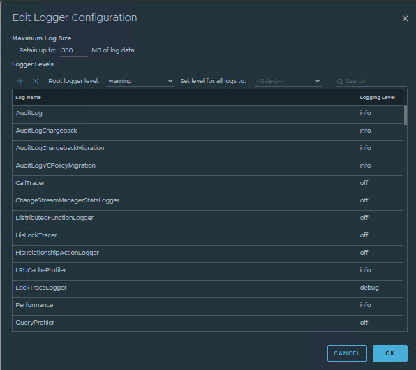

For the analytics logs to display confirmation that it has sent the SNMP trap, we need to create a logger on ANALYTICS for com.vmware.vcops.platform.notification and set to DEBUG.
Setting a class to debug on Aria Operations in Administration > Control Panel > Support Logs:
  • Ensure that the "Group by:" dropdown is set to Node.
  • Select a node from the list and expand its dropdown.
  • Then select "ANALYTICS"
  • Then click the gear icon ("Edit Properties").
  • Click on the + sign and add the class: com.vmware.vcops.platform.notification
  • Search for the same class above and set it to DEBUG
