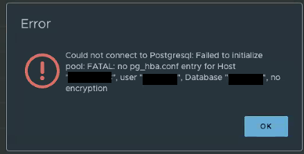

Error "No pg_hba.conf entry for host '###.###.###.###', user '<database user>', database '<database name>', no encryption." while configuring the PostgreSQL adapter in Aria Operations
Article ID: 388825
VMware Aria Suite
  • The "Validate Connection" step during the PostgreSQL adapter configuration fails with an error: "No pg_hba.conf entry for host '###.###.###.###', user '<database user>', database '<database name>', no encryption."
  • In the /storage/log/vcops/log/adapters/PostgreSQLAdapter/PostgreSQLAdapter_####.log you see messages similar to:
2025-02-12T06:48:40,147+0000 FATAL [Collector worker thread 23] (4751) com.bluemedora.exuno.DataProvider.fatal - Caught an ExUno exception while collecting: Collection failed when determining database list. Failed to initialize pool: FATAL: no pg_hba.conf entry for host "###.###.###.###", user "<database user>", database "<database name>", no encryption
com.bluemedora.exuno.common.ExUnoException: Collection failed when determining database list. Failed to initialize pool: FATAL: no pg_hba.conf entry for host "###.###.###.###", user "<database user>", database "<database name>", no encryption
VMware Aria Operations 8.x
This issue occurred because the destination PostgreSQL database is rejecting connections from the Aria Operations adapter for PostgreSQL
The pg_hba.conf file for the target PostgreSQL instance needs to be configured to permit access for the credentials, host, and database specified in the Aria Operations Integration configuration for that endpoint.
