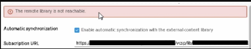

Subscribers to the vCenter Server content library may encounter an error when attempting to connect to the Publisher URL. The error message displayed is:
"The remote library is not reachable".

The issue occurs when a proxy is enabled on the Source vCenter Server Appliance (VCSA), preventing the connection from reaching the destination vCenter Server.
Exclude the destination vCenter Server Appliance (VCSA) from being routed through the proxy server using the following steps below:
