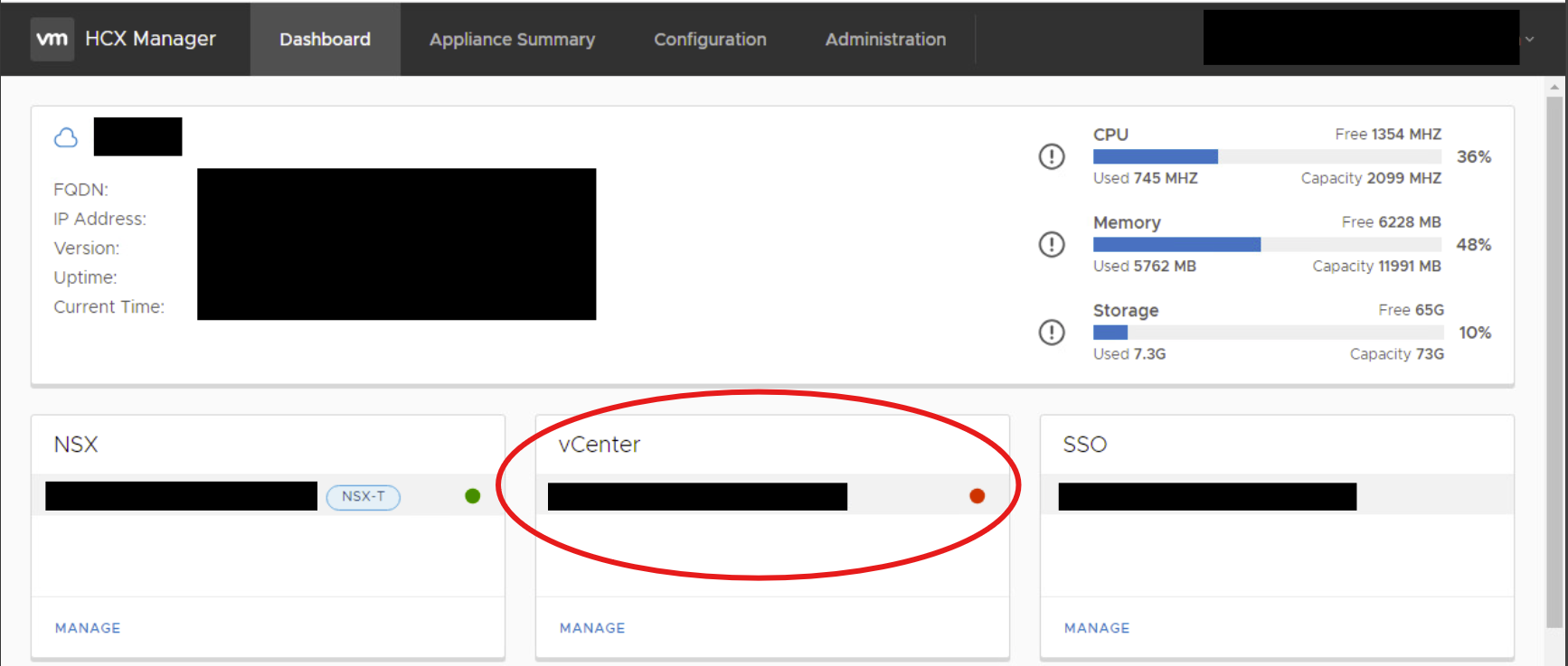

The credentials used to register the HCX Cloud Manager to the vCenter Server are no longer valid or the HCX Cloud Manager is no longer able to access vCenter server using port 443
From HCX Manager CLI as root, verify you can access the vCenter server using port 443
curl -kv https://<vCenter_Server_IP/FQDN>
Confirm Destination HCX Manager is able to access vCenter Server
Enter Valid vCenter server credentials
