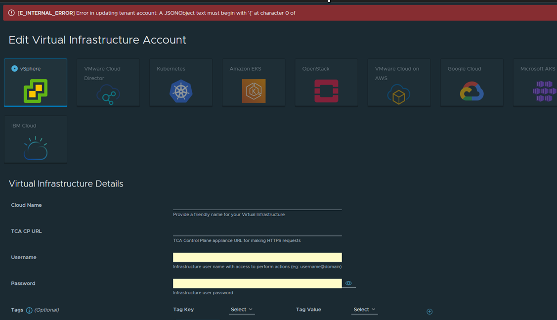

In TCA manager any attempts to edit a VIM gives the following error:
[E_INTERNAL_ERROR] Error in updating tenant account: A JSONObject text must begin with '{' at character 0 of
