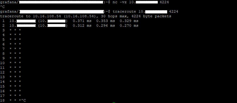

These IP addresses correspond to the NATS VMs. We performed a bosh restart on these VMs (bosh -d <TAS-deployment> restart nats), then logged into the grafana VM.
From there, we attempted to connect to the nats VMs using 'nc' and 'traceroute' (nc -vz <nats_VM_IP_address> 4224) (traceroute <nats_VM_IP_address> 4224); both commands hung. This means that communication is blocked at the firewall.
Customer must contact their internal firewall team and let them know that communication to the NATS VMs on port 4224 is required for the Healthwatch grafana VM.
