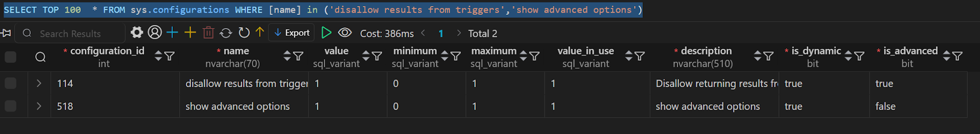

If AAI is still used, confirm with a DBA that 'disallow results from triggers' is set on the database.
If AAI is not used or as a workaround if the DBA confirms 'disallow results from triggers' is on (the column value_in _use must be set to 1):
