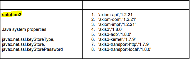

There are 2 ways to resolve this issue with Axis 1.8.0:
  1.  Solution1 - Create custom SSL context with all 1.8.0 jar
  2.  Solution2 - No custom SSL context but downgrade axis-kernel, transport and axiom
    library to 1.7.9.
See attached PDF for Java Code example for both solutions.
Solution 1:
Solution 2:
Classpath Reference:
