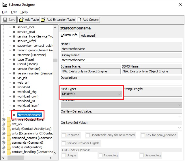

  1. In Web Screen Painter, go into Schema Designer and choose the cnt object.
  2. Create a new column called "ztestcomboname" and set the Field Type as DERIVED.

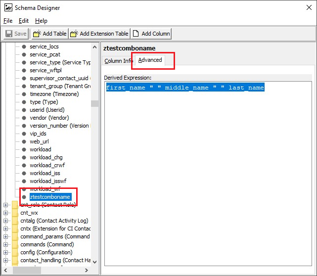

  3. In the Advanced tab, under Derived Expression, enter this text:
    first_name " " middle_name " " last_name

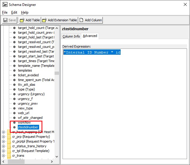

  4. Repeat the same changes described above, but update the cr object.  Please be careful to update the cr object instead of the cnt object.
    In the following screencaps, we add the DERIVED attribute "ztestidnumber" with the following Derived Expression in the Advanced tab
    "Internal ID Number " id

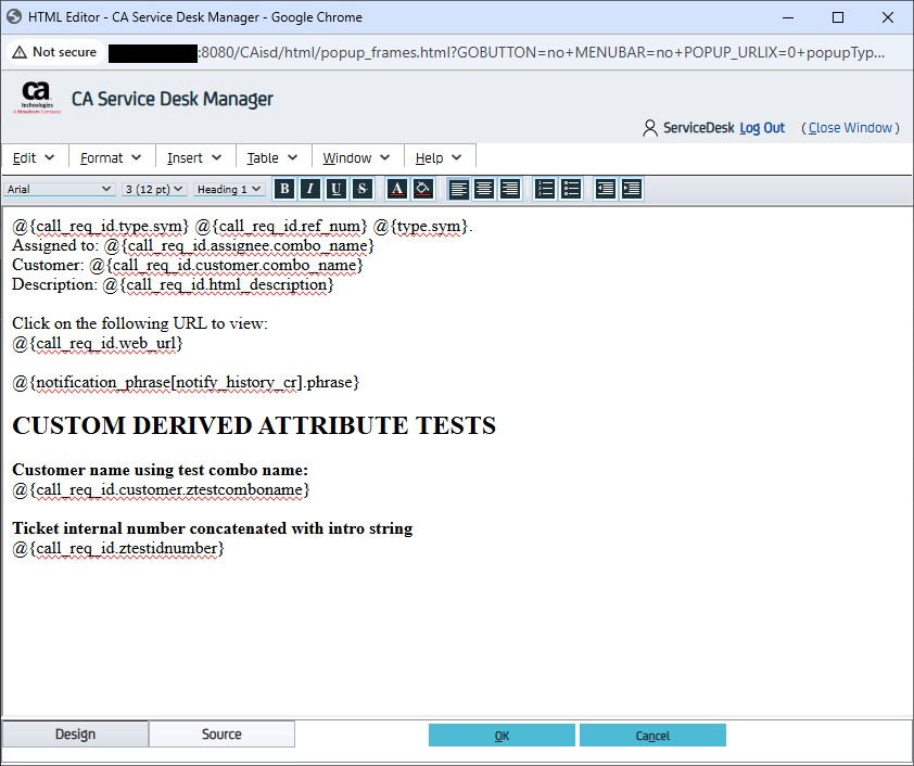

Secondly, go into the Message Template for Manual Notify (Administration tab:  Notifications -> Message Templates, and edit "Default Manual Notify message template for request/incident/problem".  Include the following code at the bottom of the message template:
CUSTOM DERIVED ATTRIBUTE TESTS
Customer name using test combo name:
@{call_req_id.customer.ztestcomboname}
Ticket internal number concatenated with intro string
@{call_req_id.ztestidnumber}

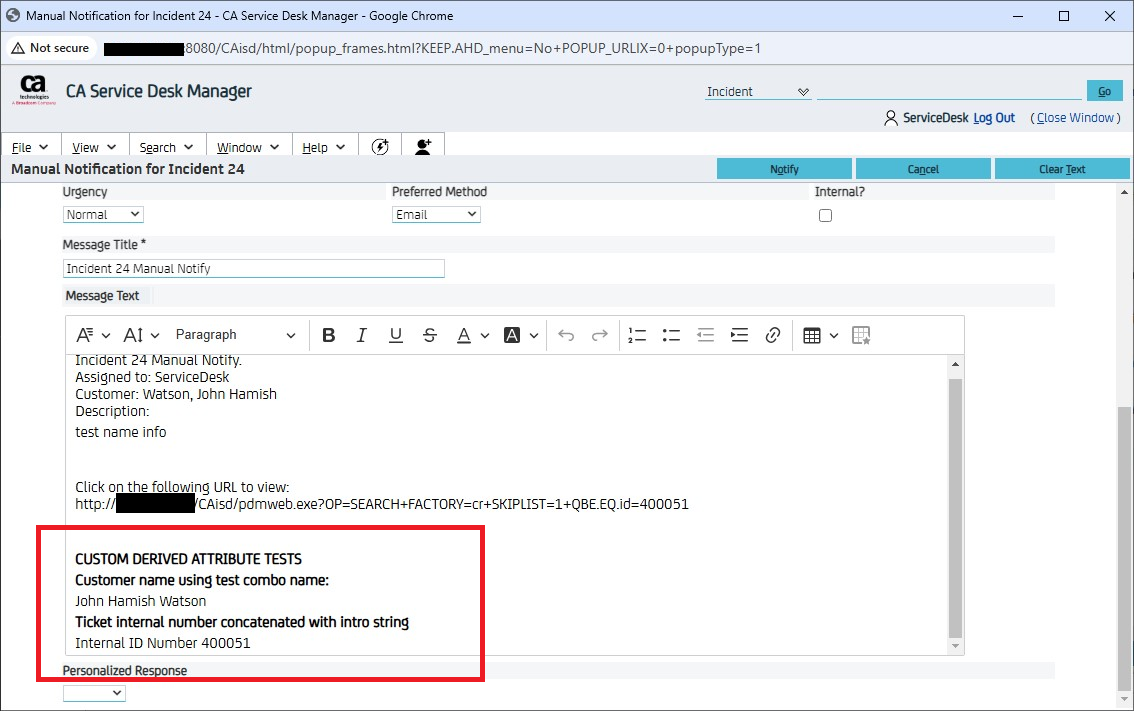

Locate a call_req ticket (Request, Incident, or Problem) with a named customer contact who has a first name, middle name, and last name, then perform a manual notify.  You will not be sending an actual email, but will be able to view the message to be sent, which will contained the processed DERIVED attributes and display their content
The message text will display as follows:
