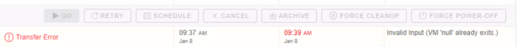

  • This error may be seen when utilizing orchestration software like Ansible to create OSAM migrations. Once the OSAM migration is created, user cancels the migration due to changes in plans or switchover window.
  • When the migration is re-created using Ansible the below error is seen:
  • In some versions, the error is just "Migration failed", "Initial Sync Failed Transfer Error", or "Initial Sync Failed Transfer Error (JSONArray[0] not found.)" but you still have matching log entries below:
