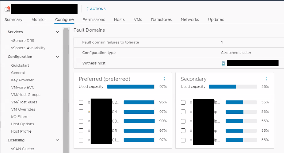

It's imperative to properly monitor the space utilization of a stretch cluster, otherwise it can result in running either low on space or out of space in a single fault domain while the other fault domain is barely used.
Possible issues:
  • VMs fail to power on with error: There is no more space for virtual disk
  • VMs fail to deploy/create with not enough space on the vSAN datastore
However the overall vSAN datastore is showing plenty of free space.
VMware vSAN
These failures are caused due to one site being used more than the other site resulting in one site filling up as seen below
