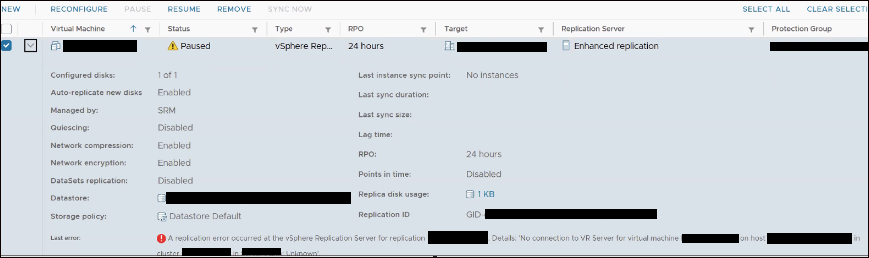

This article addresses replication failures where the vSphere Client reports "No connection to VR Server for virtual machine on host in cluster : Unknown." This typically indicates a network communication failure along the replication data path.
Replication tasks complete, but synchronization fails.
vCenter UI displays: "No connection to VR Server for virtual machine: Not responding".
Site Recovery UI reports:
"A replication error occurred at the vSphere Replication Server for replication [vm_name]. Details: 'No connection to VR Server for virtual machine [vm_name] on host [esx_name] in cluster [cluster_name]: Unknown"
