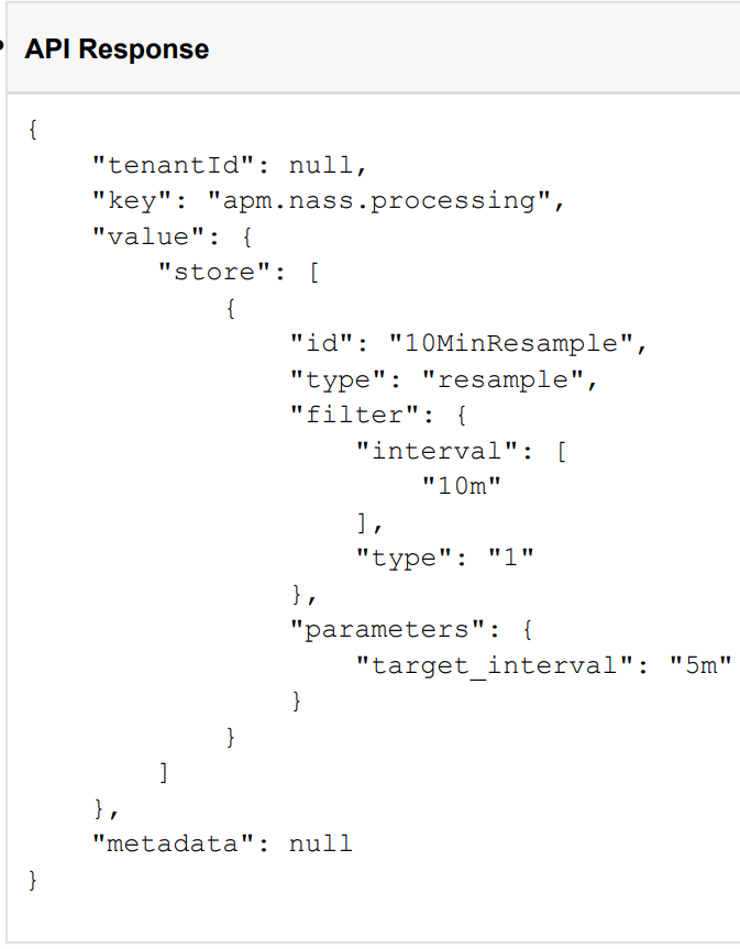

1. Update the Configuration
Endpoint:
POST <apmservices-gateway>/configuration/store
Authentication: This endpoint requires a valid internal token for authentication. This token should be included in the request headers as:
Authorization: Bearer <internal_token>
Description:
This endpoint stores a resampling configuration with a global setting. It defines the 10-minute resampling process to 5 minutes, which operates with a internal token.
Request Payload:
 "key": "apm.nass.processing",
 "value": {
   "store": [
      "id": "10MinResample",
      "type": "resample",
      "filter": {
      "interval": ["10m"],
      "type": "1"
    "parameters": {
      "target_interval": "5m"
Response:
   Status Code: 200 OK

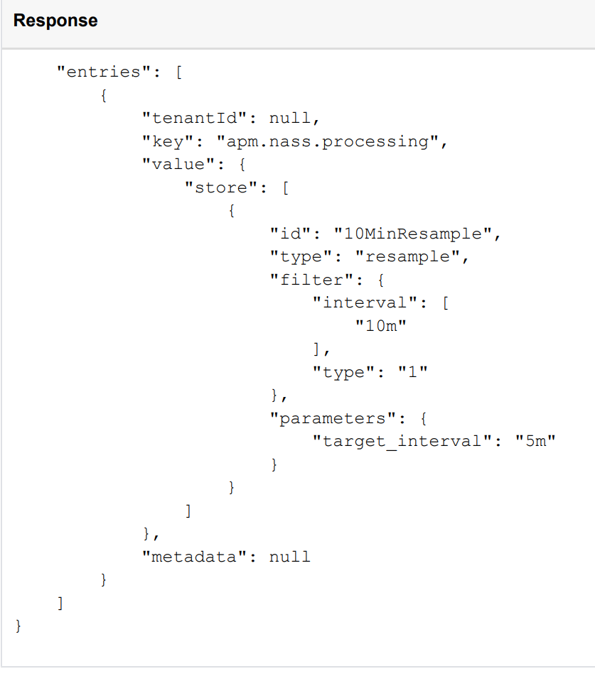

2. Validate the change:
Users can use this API to validate whether the configuration is saved or not
Endpoint:
POST <apmservices-gateway>/configuration/query
Description:
This endpoint queries the configuration based on specific filtering criteria. It’s used to fetch the stored resampling configuration
 "filter": {
   "op": "OR",
   "input": [
     "op": "EXACT",
     "keys": [
Response:
   Status Code: 200 OK
