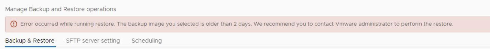

  • When you attempt the restore of HCX from SFTP backup, you encounter below error :
    Error occurred while running restore. The backup image you selected is older than 2 days. We recommend you to contact Vmware administrator to perform the restore.
