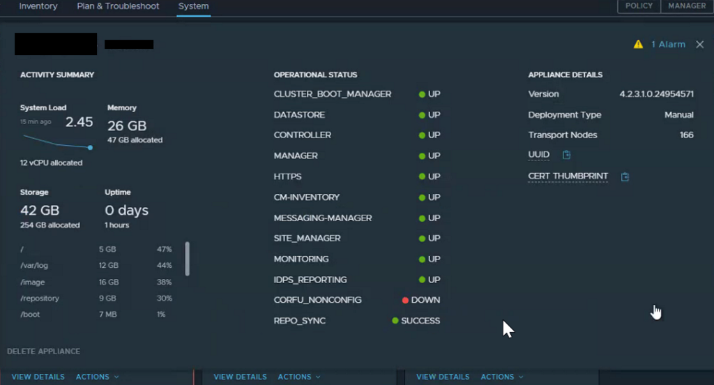

Corfu/Corfu-nonconfig status is not up
Article ID: 386799
VMware NSX
  • Corfu/Corfu-nonconfig node status is in DOWN/DEGRADED state in the NSX Manager UI
  • VMware NSX
  • VCF 9.0 and above
