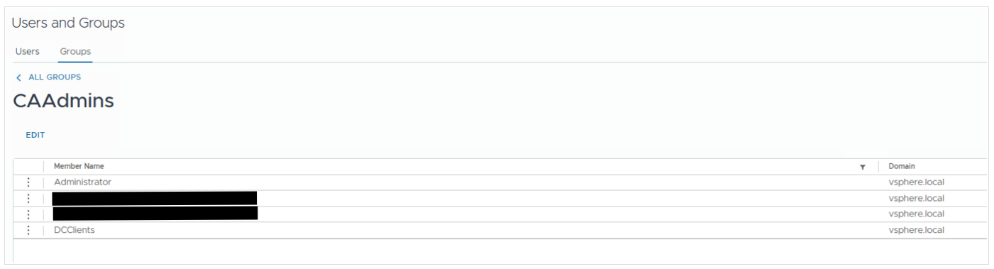

  • The issue is caused by the absence of the DCAdmins group in the CAAdmins SSO group.
  • This missing group leads to authorization issues within vCenter Server operations, which prevents the ESXi host from obtaining the necessary VMCA-signed certificate.
  • The following snippet shows that the DCAdmins group should be part of the "Users & Groups" section:
  • The following snippet shows that the DCAdmins group should also be included in the CAAdmins SSO group:
