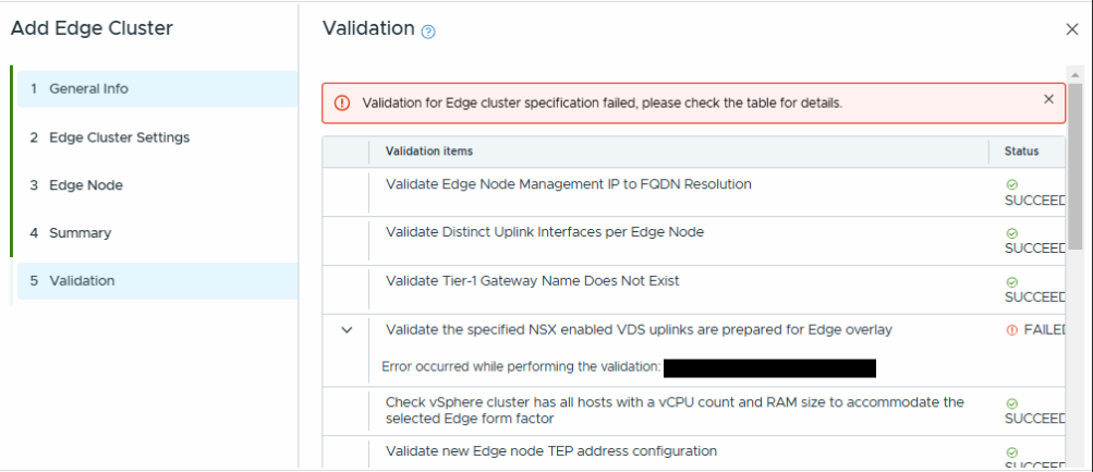

During cluster expansion or while adding an edge cluster you see the following error:
